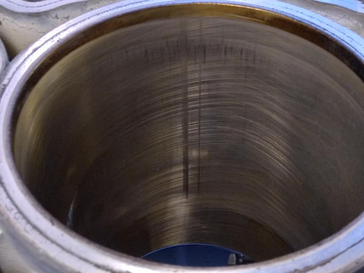

Have a little problem in cylinder 1. Slightly scored. Neville says this in not so uncommon. He has seen it before. He said to sand it down and just go with it. Got the highs knocked off and can only feel a little valley with my finger nail.

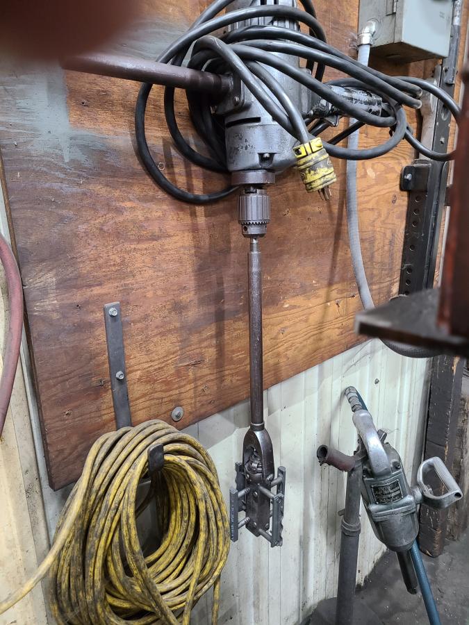

Lead machinist at the shop I took the head to said it doesn't look bad to him either. He said if I bring the bike over he will run a hone in there for me for free. He said it will only take a few seconds with the hone to clean it up.

And if you let the gubment do it with their super duper asshole hone with the built in ridge reamer they use on the U.S. population, it will only take a few seconds ðŸ˜Originally posted by skydog1000 View PostYes it will only take about 60 seconds too Clean it up and make it look brand new.

Had the machinist at the shop doing my head work run a hone through the 3 cylinder bores today. Just 10 seconds in each hole and they turned out looking great. The scratches in cylinder 1 are gone. Happy Day.
