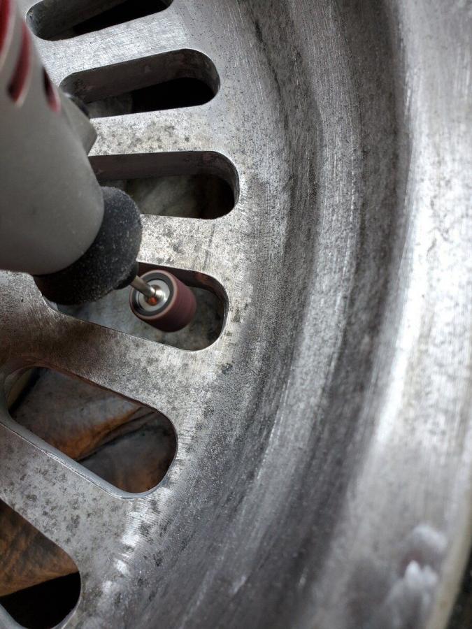

    Two days later, and I am still sanding the rim by hand. I know I must protect it somehow once I get it shined up. I decided that I will have the rim powder coated. I looked it up on line to see if there is a DYI method I could use when I discover that most shops bead blast the aluminum rims before coating. It takes a few minutes to prep this way. I have been sanding for days no and have a long way to go if I keep doing this by hand.
    Just working on the rear rim, I have yet to remove the front wheel. I will get to that today I hope and drop them off tomorrow for professional cleaning and coating.

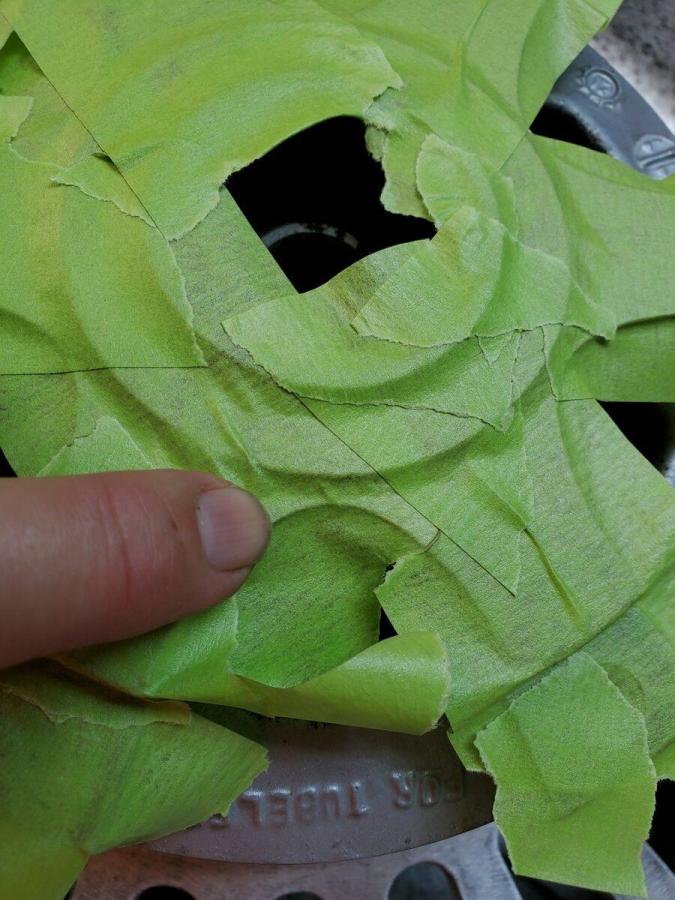

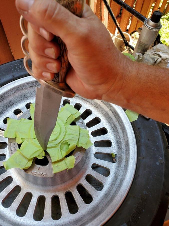

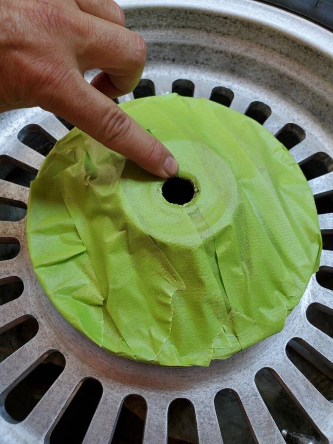

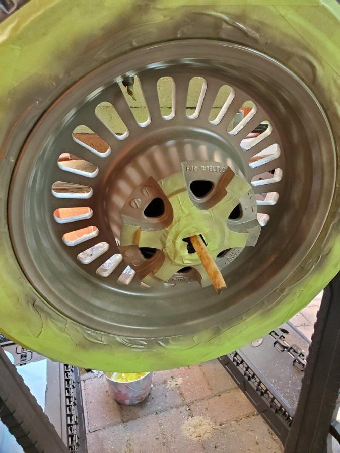

                Make sure you gently cut away the tape with a sharp knife.

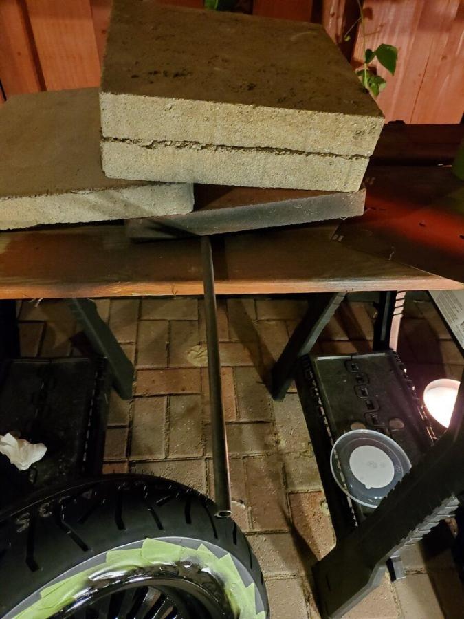

                  The bamboo rod didn't make it. Luckily I found a copper rod that would suffice.Click image for larger version  Name:	 Views:	0 Size:	300.9 KB ID:	15771

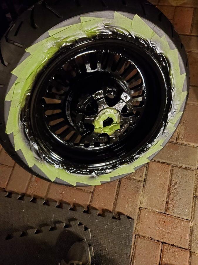

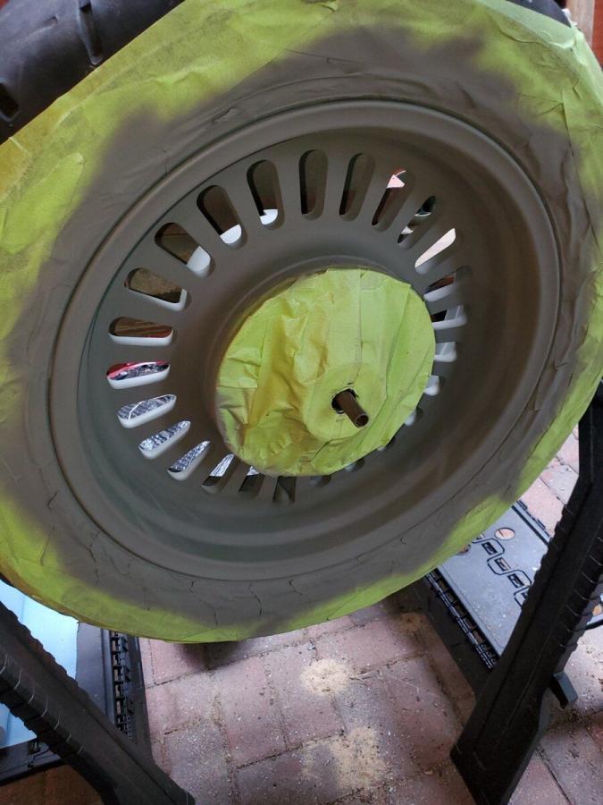

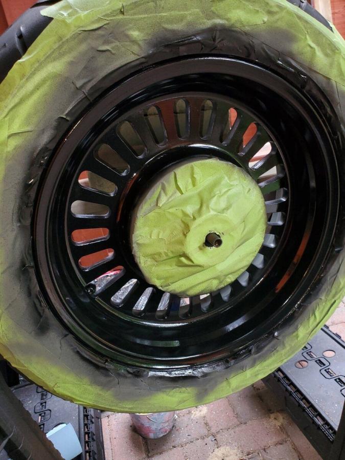

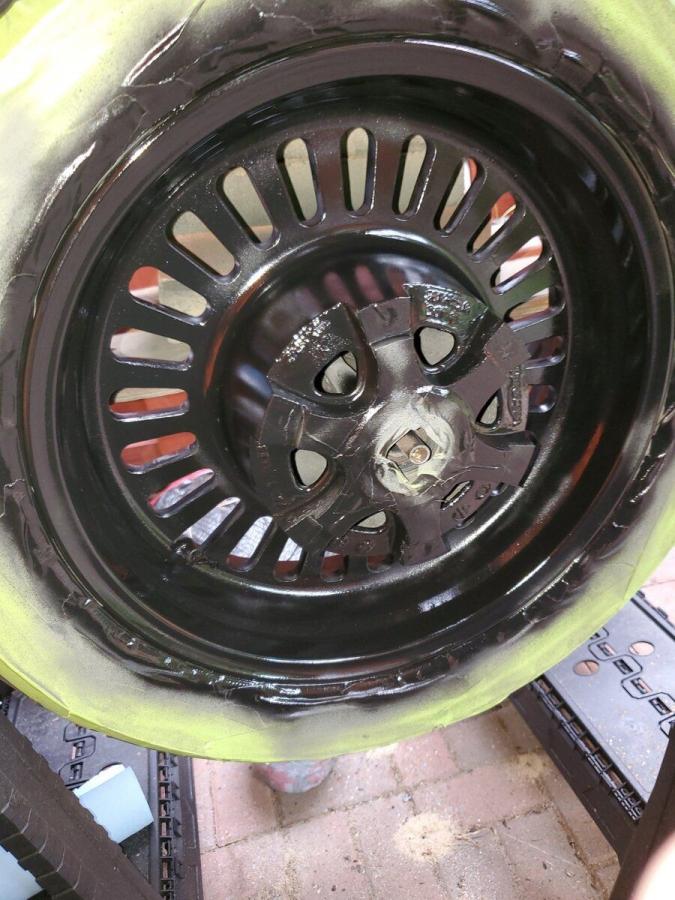

                    The first coat of shiny black is on.
Name:
ID:	15773 Click image for larger version
Name:
ID:	15774 First coat of shiny black is on.

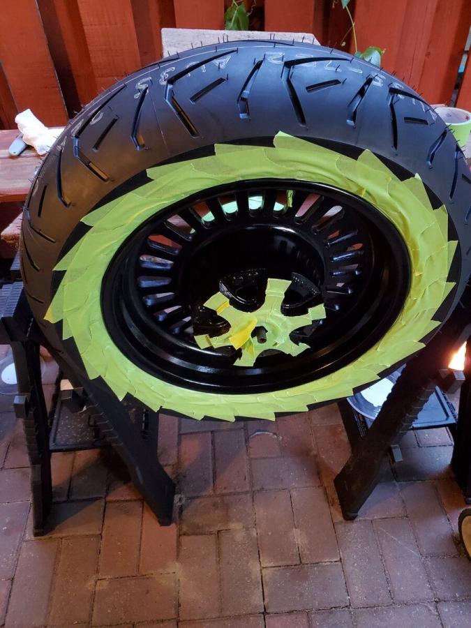

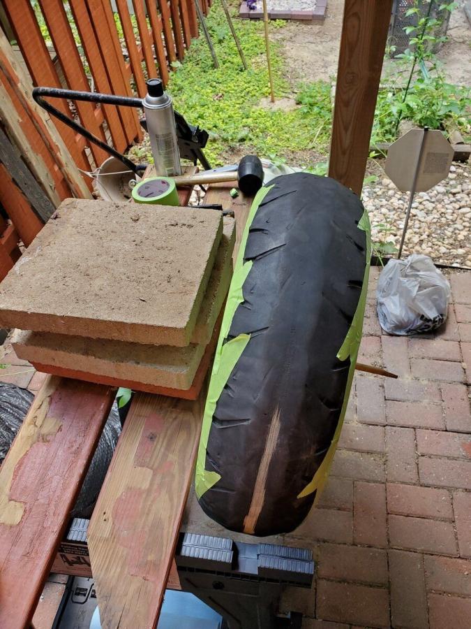

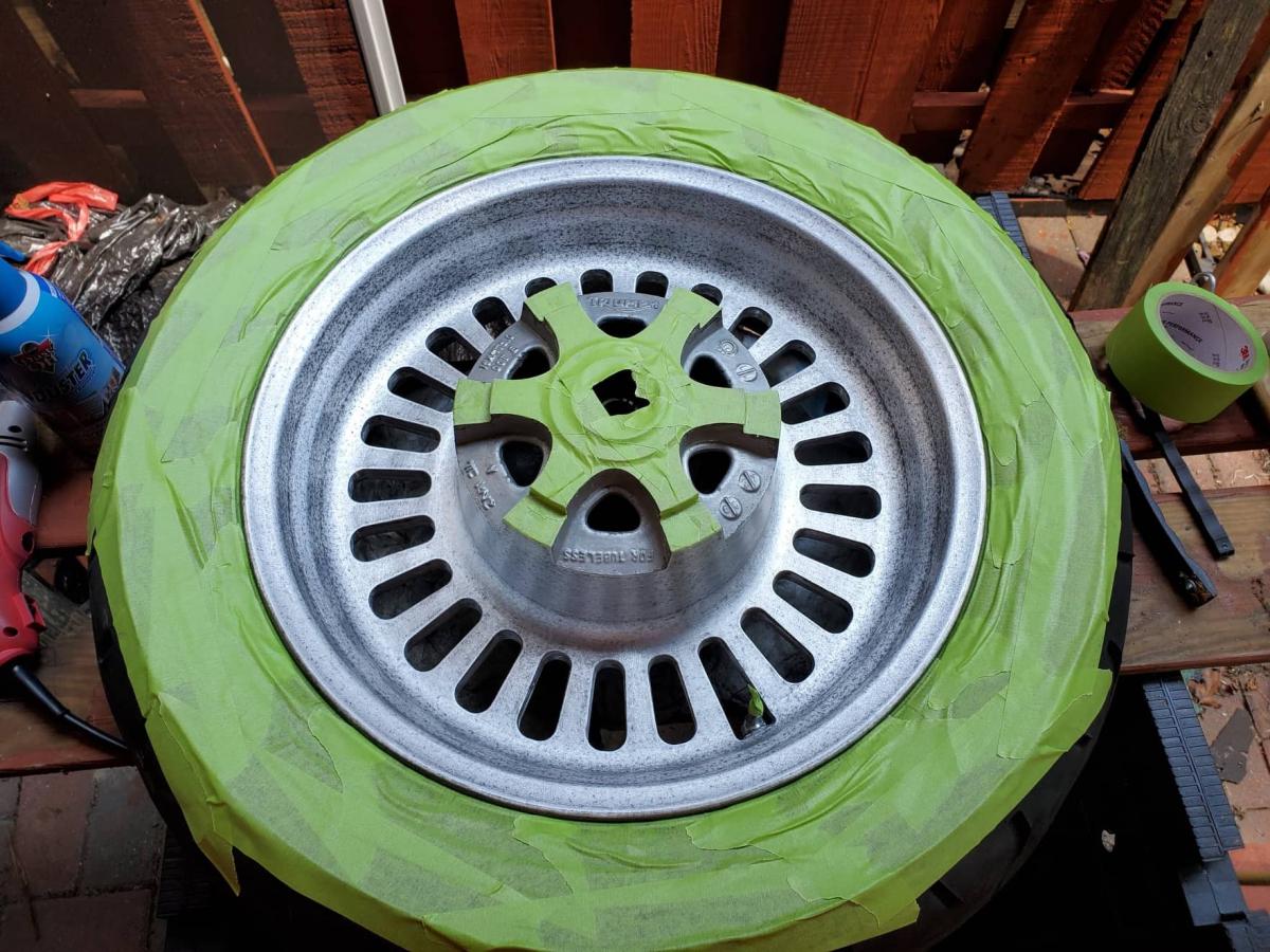

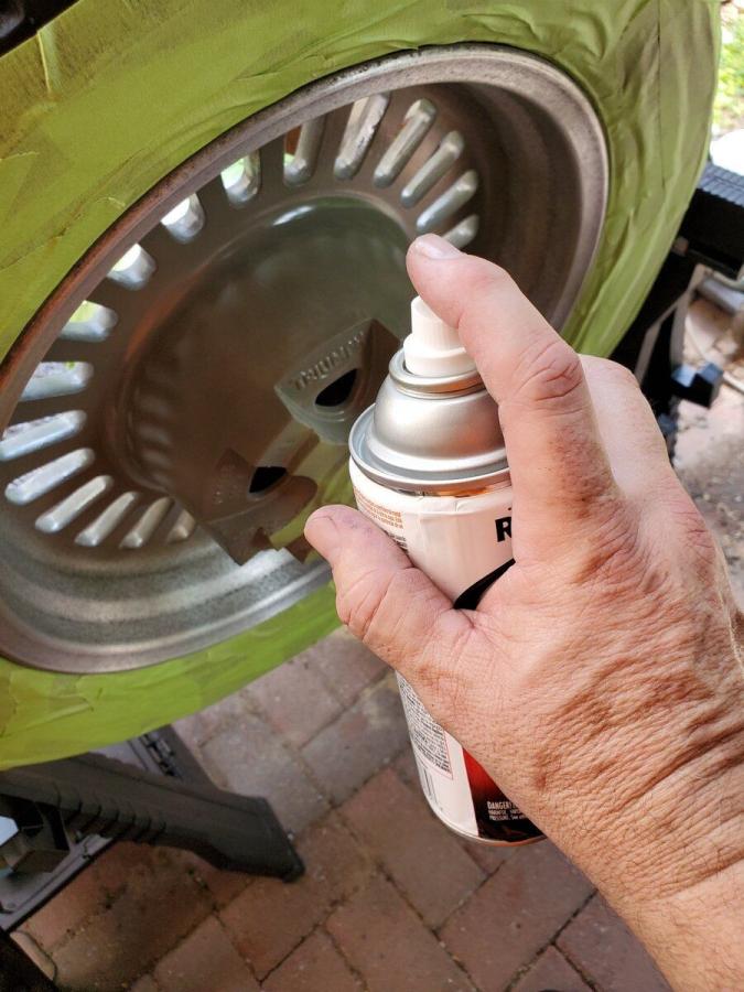

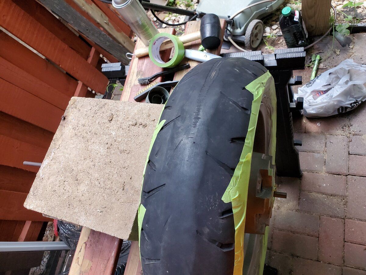

                      Well, I am back at it again. New tire is installed and they coat of black. Then it got three coats of clear.
                      First to retape the fat tire

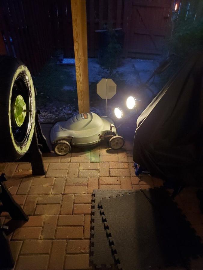

                      The sun left thus auxiliary lighting was required.

                      My makeshift jig.

                      Final spray
                        I am curious about why you bothered to tape the throw away tire. I understand for the new one.
                          Steel I simply did it for practice.
