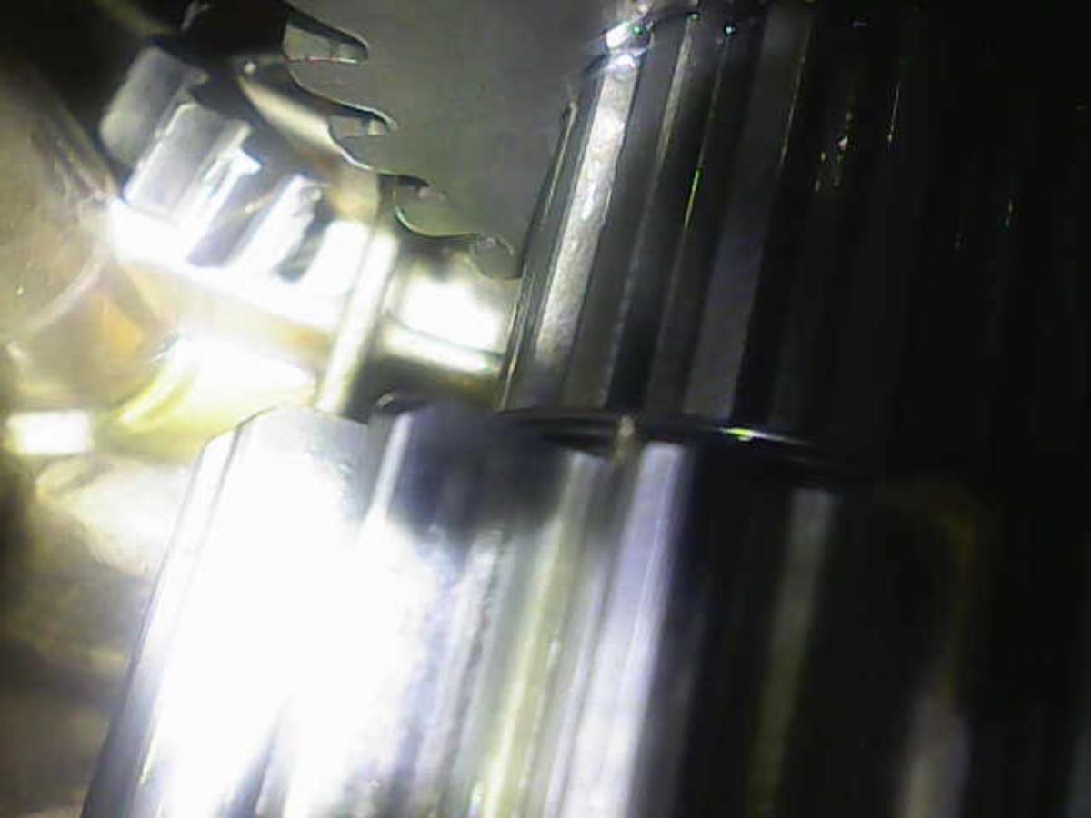

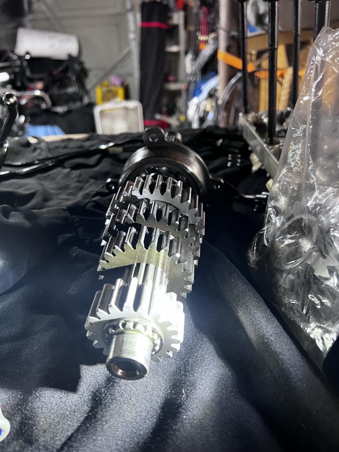

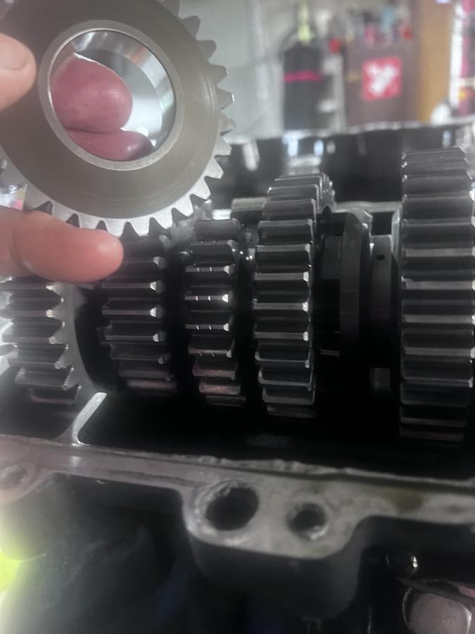

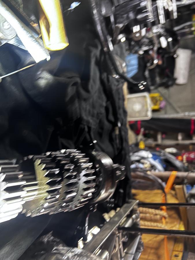

                Mine was torsional damper and broke 4th gear on output and the 3rd 4th slide dog on input took a chip, mine happened under hard acceleration while already turning 6k
                  Some pictures of damage
