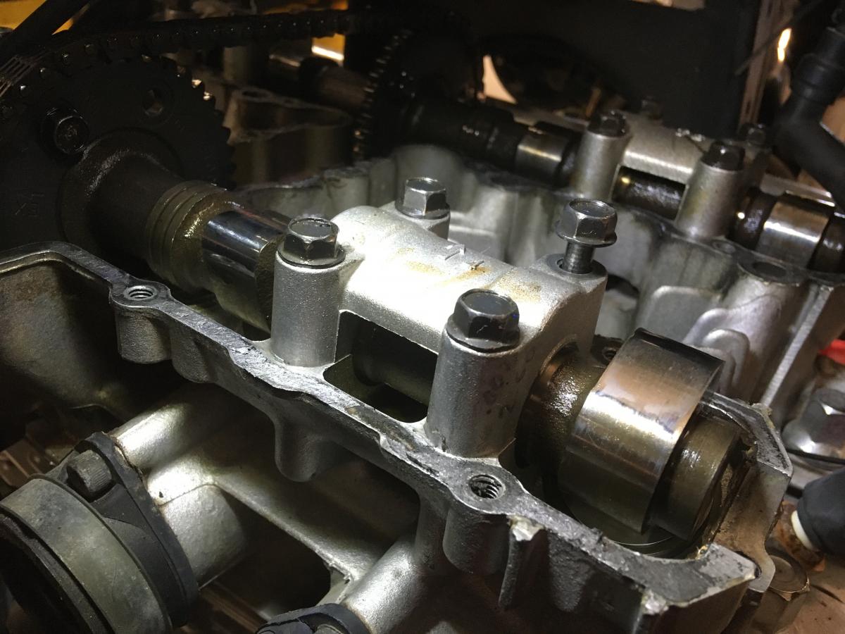

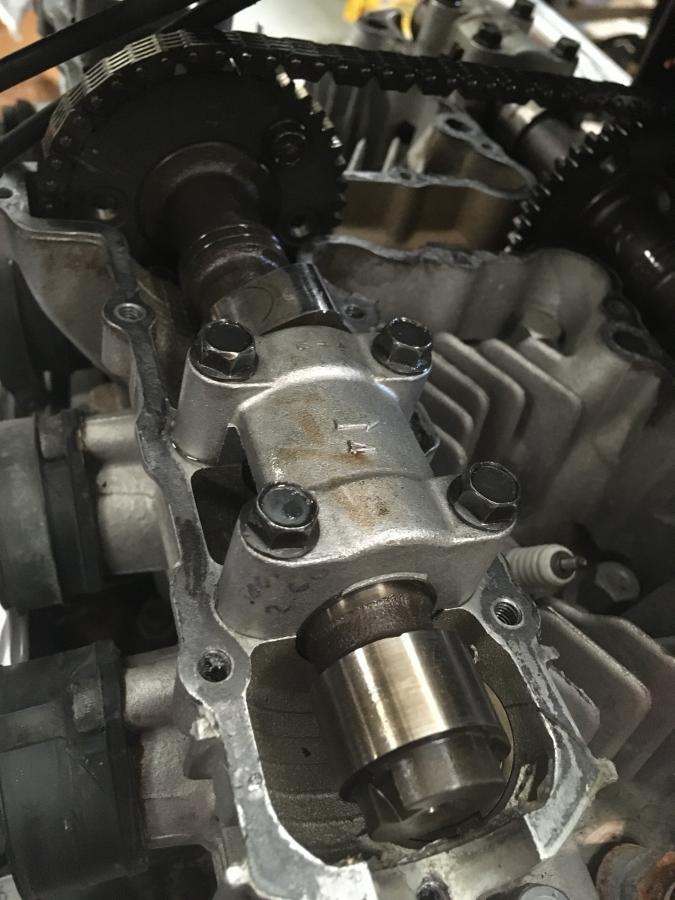

    F^&(^ by a typo in a 20 year old Kawasaki FACTORY manual. I should have gone with my gut - 12 ft-lb on an M6 seemed high. Also shouldn't have trusted Imperial units (lbf-ft) in a Japanese sourced manual.
    Click image for larger version  Name:	IMG_0723 ADJ.jpg Views:	0 Size:	71.7 KB ID:	4306
    Now what????

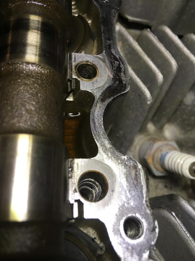

    Fixed both the stripped cam bearing holes in KZ
    First put cam lobes associated with bearing cap to as near base circle as I could to prevent possibly damaging cam
    Click image for larger version  Name:	IMG_0735.JPG Views:	0 Size:	123.4 KB ID:	4933

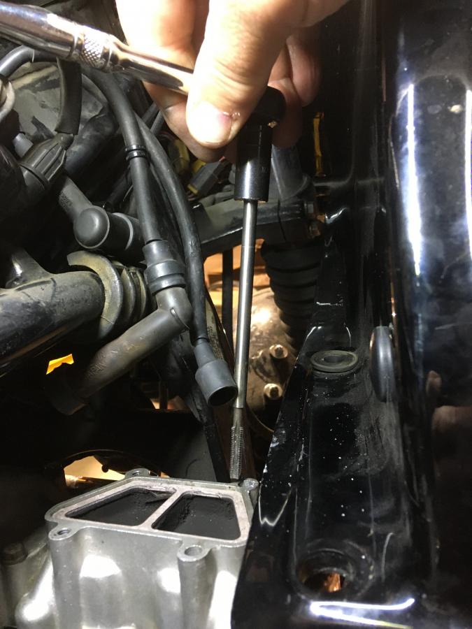

    On one cap the stripped hole held the bearing register, which conveniently made an excellent drill guide
    Click image for larger version  Name:	IMG_0744.JPG Views:	0 Size:	60.6 KB ID:	4934

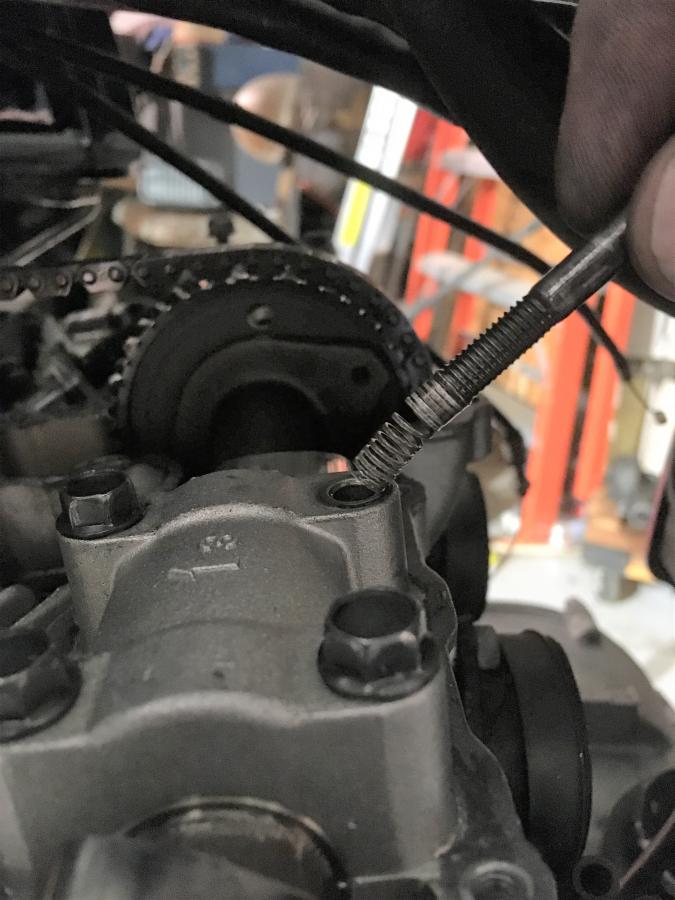

    loading grease on the drill and tap caught the shavings
    Click image for larger version  Name:	IMG_0742.JPG Views:	0 Size:	55.2 KB ID:	4935

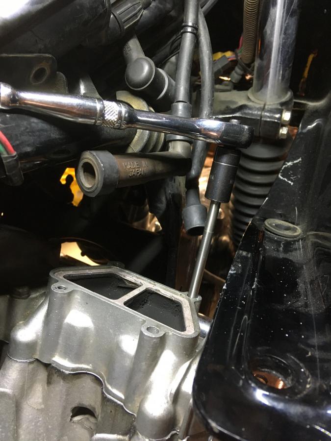

    Installed helicoil making sure it was below dowel pin shoulder
    Click image for larger version  Name:	IMG_0743.JPG Views:	0 Size:	69.1 KB ID:	4936

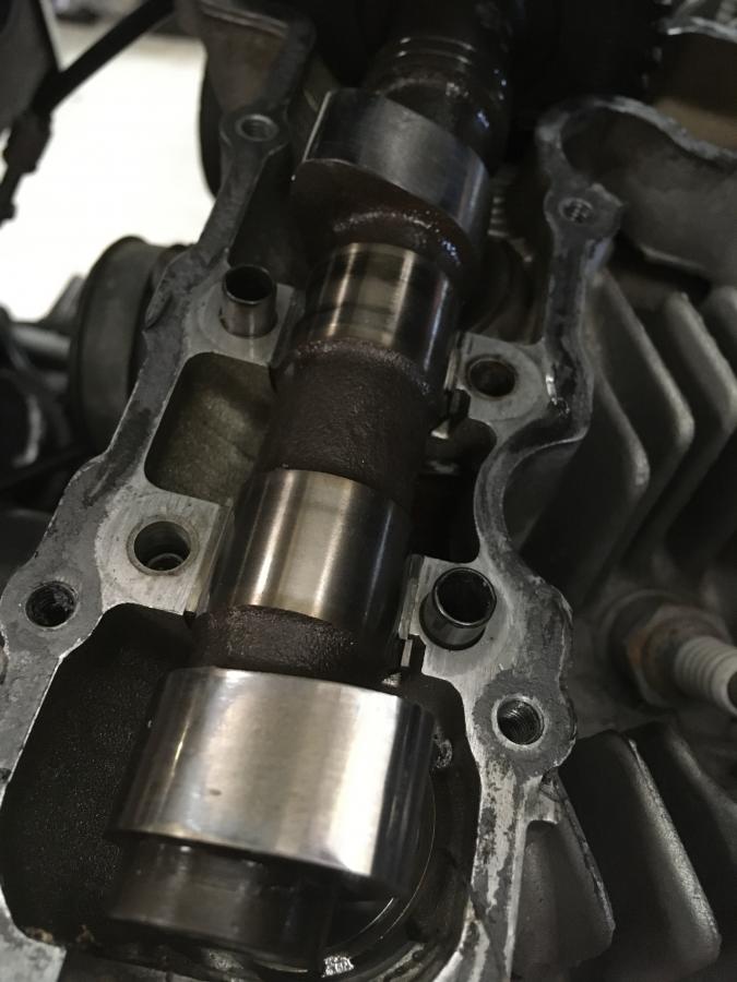

    Job done with torque to reasonable 105 lbf-in vs 12 lbf-ft (factory manual)
    Click image for larger version  Name:	IMG_0746.JPG Views:	0 Size:	75.0 KB ID:	4937

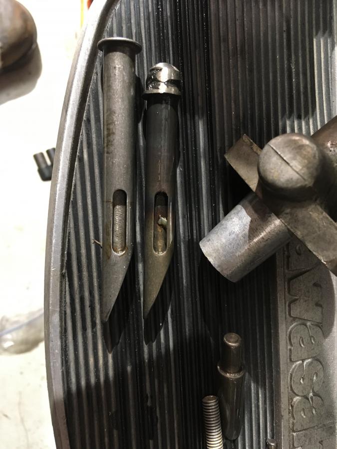

      Fixing more stripped threads -these on the valve cover. Bolted down the cover with a $45 gasket and some silicone in selected places - wouldn't you know it, bolt was stripped where it had been leaking. Ebay tools to the rescue. My 6mm thread are now 1/4-28. I'll helicoil them back at the next valve check
